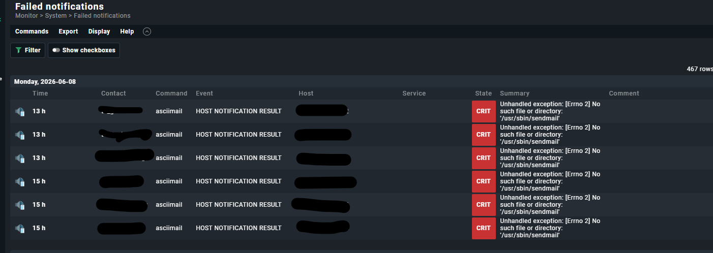

CHeckmk still try to use sendmail instead of my script , which cause failed notification
CMK version: Community 2.4.0p24
OS version: Ubuntu 24.04
Hi All,

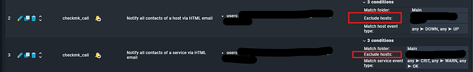

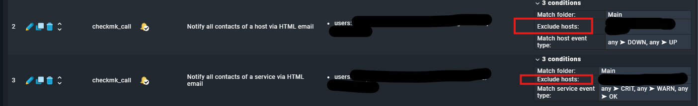

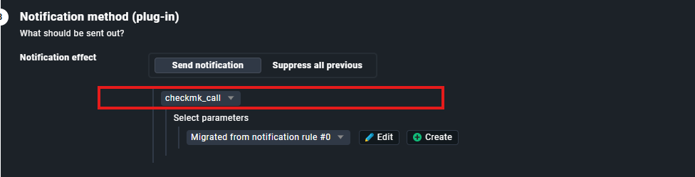

I am using my own script checkmk-call for notification, rather than use HTML/ASCIIMail which use the sendmail from Ubuntu. My notification rules covers all the host/service so it shouldn’t need to fallback to the fallback email address which I haven’t set, but 2 of rules use the "exclude host ", I am suspecting whether there is a bug which this “exclude host” setting that I should not use it. Can any one help ?
One more question, in the previous Community version "2.1.0P15 that I used , I was tolder by one of the checkmk support that I should not select both "match host event type " and “match service event type” in a single notification rule, i should split them into 2 rules, 1 rule for each for each event type. may I know in Community 2.4.0p24 which I am currently use, it is still the same ? Or I can include both host event type and service event type in 1 rule . Please help
Thanks

For your original problem, i would look at the “notify.log” file to see why the asciimail plugin is triggered. Please keep in mind that this can also be triggered by any personal notification rules inside CMK.

These two are the important lines. No rule matches and now it uses a fallback address. This address is somewhere configured. If you find it you will fix your notification problem.
The why it not matches you can only see inside the notify log. Like in your previous post you should see a reason inside the log file.
