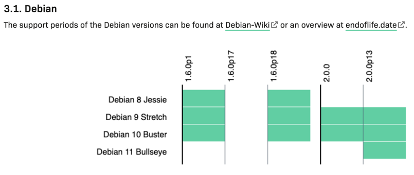

2.0.0p6 is very old.
In the update matrix you can see that Debian 11 was only supported from p13.
Upgrade paths for checkmk and Linux are always very well described in the respective documentation.
For Linux upgrades you should pay attention to this.
If there are backups, I would go back to the working version with Debian 10.
Then upgrade checkmk to the latest 2.0 version 2.0.0p39 and then upgrade Debian to 11 and then of course install the Debian 11 Checkmk 2.0.0p39 version as described in the documentation.
