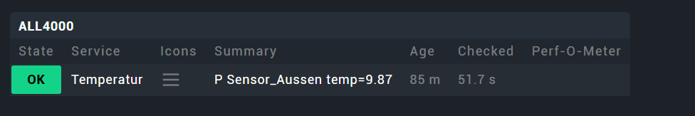

Hallo,
Currently I successful run my bash scripts on the checkmk instance.
This bash script returns (it should) also performance data.
grafik
But this data are not processed from check_mk.
What I’m doing wrong?
Maxe
The script output looks more like local check. This script should be called be the agent as a local check. Then also the performance value is interpreted correctly.

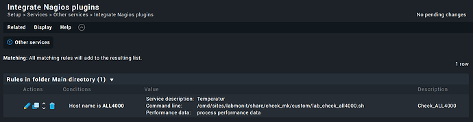

There is also another problem i see. You put your script inside the folder “~/share/check_mk/custom/”.
That’s not good as with the next update your check is lost.
If it is a classic check please put the file inside “~/local/lib/nagios/plugins/”. For the command line definition you can then use the macro “$USER2$” as this is the path to the local plugins folder.
Such local checks like this one you can put inside “~/local/share/check_mk/agents/local” for instance but for the raw edition it is not so important. Only inside the “~/local/” structure to not get lost during update processes.

The “P” at the start of the line indicates that it is a local check who has a status that depends on the performance data and the limits of these. Only your performance data has no limits. That means the checks stays ok all the time.
If your output looks like this.
P Sensor_Aussen temp=9.81;35;45
You would get automatically a Warn at 35 and Crit at 45 degrees.

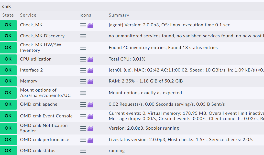

Your CMK server needs to be a normal monitoring object in your setup like every other Linux server.
You should see there some OMD checks and normal Linux checks.
Like this example
The description how to do this can be found here. The agent for Linux in detail
There are many ways how to monitor a Linux system, you can chose the best suited one for your environment.
If your server is visible inside your CMK instance you can put your local check script on your monitoring server inside the folder “/usr/lib/check_mk_agent/local/” it it will be executed every time the data from your agent is pulled. The processing of the performance data is done automatically. You don’t need to do anything for this.

??? With PRTG and NAGIOS you do exactly the same. You define an object and assign manually your check to this object. With CMK you don’t need to define an extra object as you should have already your monitoring server itself in your monitoring. You only need to deploy the script (your script is an CMK local check) on your monitoring server itself.
If you have not an local check but an classic Nagios check you can also use the “Classic active passive checks” (1.6) or “Integrate Nagios plugins” (2.0) rule to assign these checks to a dummy object in your monitoring. This is exactly the same what you do inside Nagios or PRTG.
