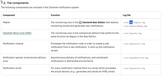

I think you are looking for the notify log: Checkmk on the command line - Understanding and using command line commands and here:
Notifications - via Email, SMS, ticket system and more

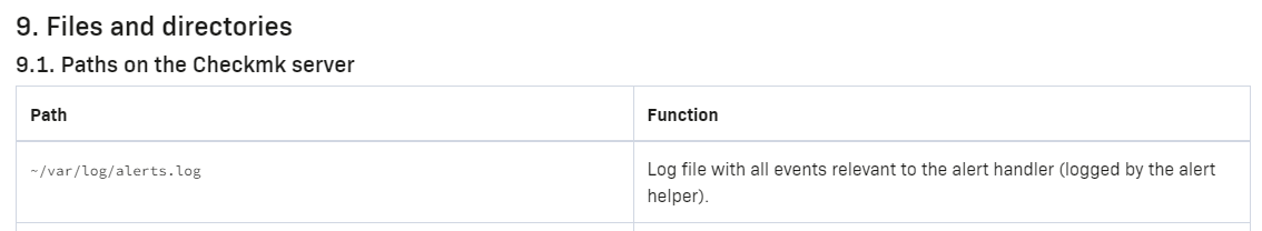

This is a wording particularity of Checkmk where alerts != notifications. Checkmk creates a ‘notification’ whenever there’s a state change.
An ‘alert’ is similar to a notification but not the same, and the alerts.log covers only those.
Read more here: Alert handlers - Responding to problems automatically

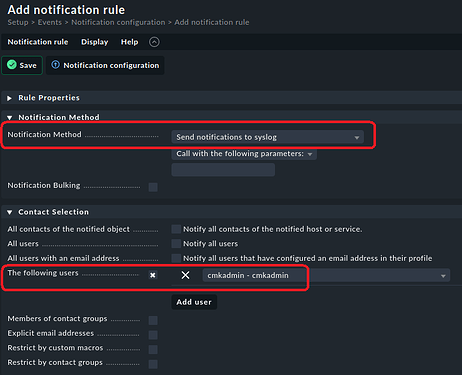

Put it in ~/local/share/check_mk/notifications/ (the name doesn’t matter) and make it executable. Then create a notification rule with this script.
Make sure to select only one user (which one doesn’t matter) as a contact for this rule. If you leave it at the default (all contacts…) then a syslog message is issued for every single contact of that host/service. You don’t want all those duplicate syslog messages.
