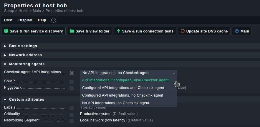

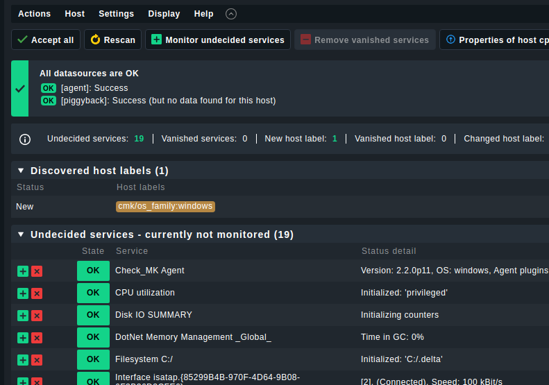

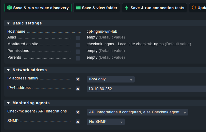

I am new to this application. So far, I’ve managed to get a Checkmk server up and running, and I am monitoring 67 hosts and 828 services, using SNMP and impi.
I am now trying to add the first of several Windows server virtual machines.
The virtual machine platform is Oracle VM Server for X86. (a Xen-based hypervisor tech.
I have installed the Checmk agent on the Windows server and registered it with the CheckMk server. However, I have encountered the error message above when running connection tests and service discovery from the Checkmk server GUI.
Where do I start looking for the problem?
Any advice will be much appreciated.

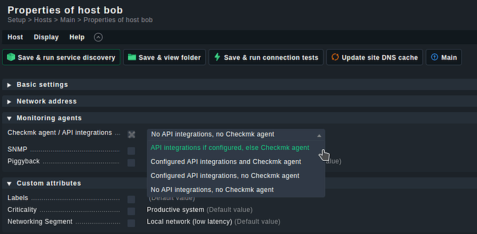

Your host is set to “No Agent”. This means that checkmk will only Ping this host. To use the agent as data source you need to select the first dropdown option from “Checkmk agent / API integrations” as shown in the screenshot below.
But it is configured to use the agent in the GUI. See the screen dump for my setup.

please use the hostname instead of a IP for executing the commands.
cmk -D cpt-ngms-win-lab
cmk --debug -vvn cpt-ngms-win-lab
OK. Here you go.
:~$ cmk -D cpt-ngms-win-lab
cpt-ngms-win-lab
Addresses:              10.10.80.252
Tags:                   [address_family:ip-v4-only], [agent:cmk-agent], [checkmk-agent:checkmk-agent], [criticality:prod], [if_alias_desc:if_alias], [ip-v4:ip-v4], [networking:lan], [piggyback:auto-piggyback], [site:checkmk_ngms], [snmp_ds:no-snmp], [tcp:tcp]
Labels:                 [cmk/site:checkmk_ngms]
Host groups:            check_mk
Contact groups:         check-mk-notify, all
Agent mode:             Normal Checkmk agent, or special agent if configured
Type of agent:
  Program: /omd/sites/checkmk_ngms/share/check_mk/agents/special/agent_ipmi_sensors 10.10.80.252 ipmiuser ipmiuser ipmitool user --intf lanplus
  Process piggyback data from /omd/sites/checkmk_ngms/tmp/check_mk/piggyback/cpt-ngms-win-lab

Agent exited with code 1: ERROR: 'Error: Unable to establish IPMI v2 / RMCP+ session
, Error: Unable to establish IPMI v2 / RMCP+ session
you have configured a special agent for this host so the normal agent keeps getting skipped.
Type of agent:
Solution:
Either set the option to “Configured API integrations and Checkmk agent” or remove that Special Agent config.
In addition to @SvenH your configured special agent cannot fetch any data.
A-Ha! That was it. Problem resolved! Thank you so much. This had me pulling out my hair.
Agent = Success!
Thanks for the message.
Yes. This special agent is applied via a rule that is applied to an upstream folder, but is actually irrelevant to the Windows virtual machines. This setup is due to poor planning on my side. I am new to this app, I am learning as I go. For now, I’ve updated the rule to exclude this particular VM. However, I will have to redo my folder layout.
Does your windows virtual servers have a specific host label? If so and you want to keep the same existing folder set up you could just re configure the rule to exclude host label “whatever the host label is for the virtual servers” meaning the folder set up can remain the same but the rule will not apply to windows virtual servers.
The above is the same in theory as to what you have just done by excluding a host, however rather than exclude potentially a lot of hosts it will do it across your whole site.
Thanks for the advice @Newtocheck . I have not defined any labeIs, yet. However, your suggestion makes more sense compared to having to explicitly exclude every host. I will do that instead. Thanks!
