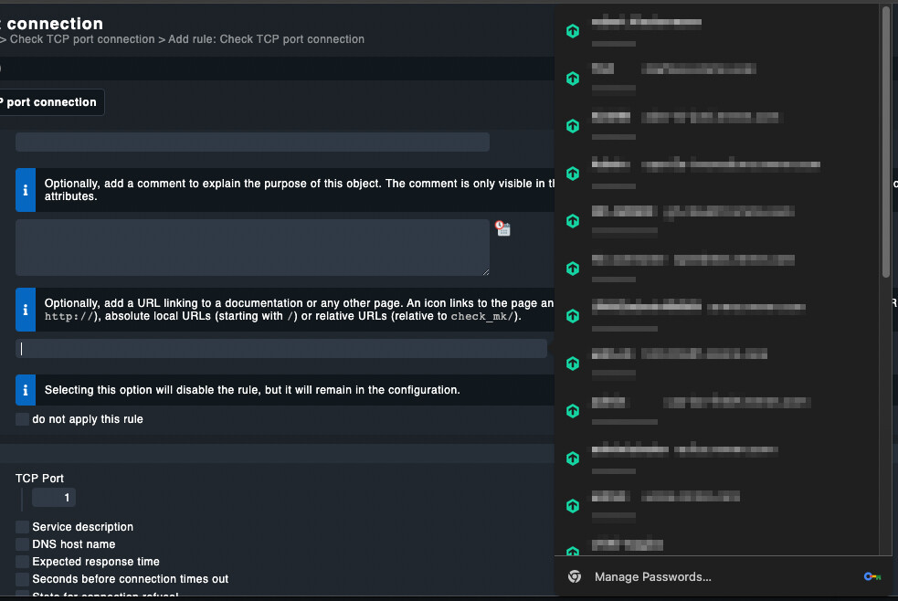

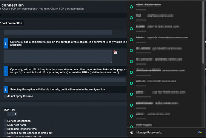

On a page where this bug happens, when I remove the username and click into the field, Chrome opens a long list of user/pass combinations with a “manage passwords…” button at the bottom, just like it does on regular username or password fields:

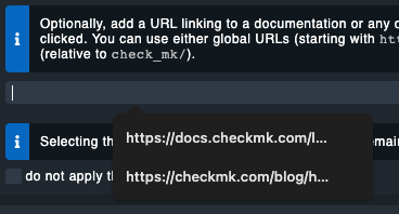

When I click into an (empty) documentation URL field on a rule page without the bug happening, it opens a regular autofill/remembered inputs list that looks like a speech bubble. This list is much smaller and contains things that I’ve put into this field in the past:
More importantly though, it does not automatically populate the field. We can surely agree that this is the expected behaviour.
