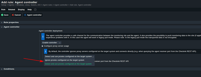

Have you already tried this?
No I haven’t but how I understood that option, this are two different things. That option says to consider variables like “HTTPS_PROXY” configured on the agent server. I don’t have a normal HTTPS proxy, but a reverse proxy in the middle which should be transparent to the agent.
