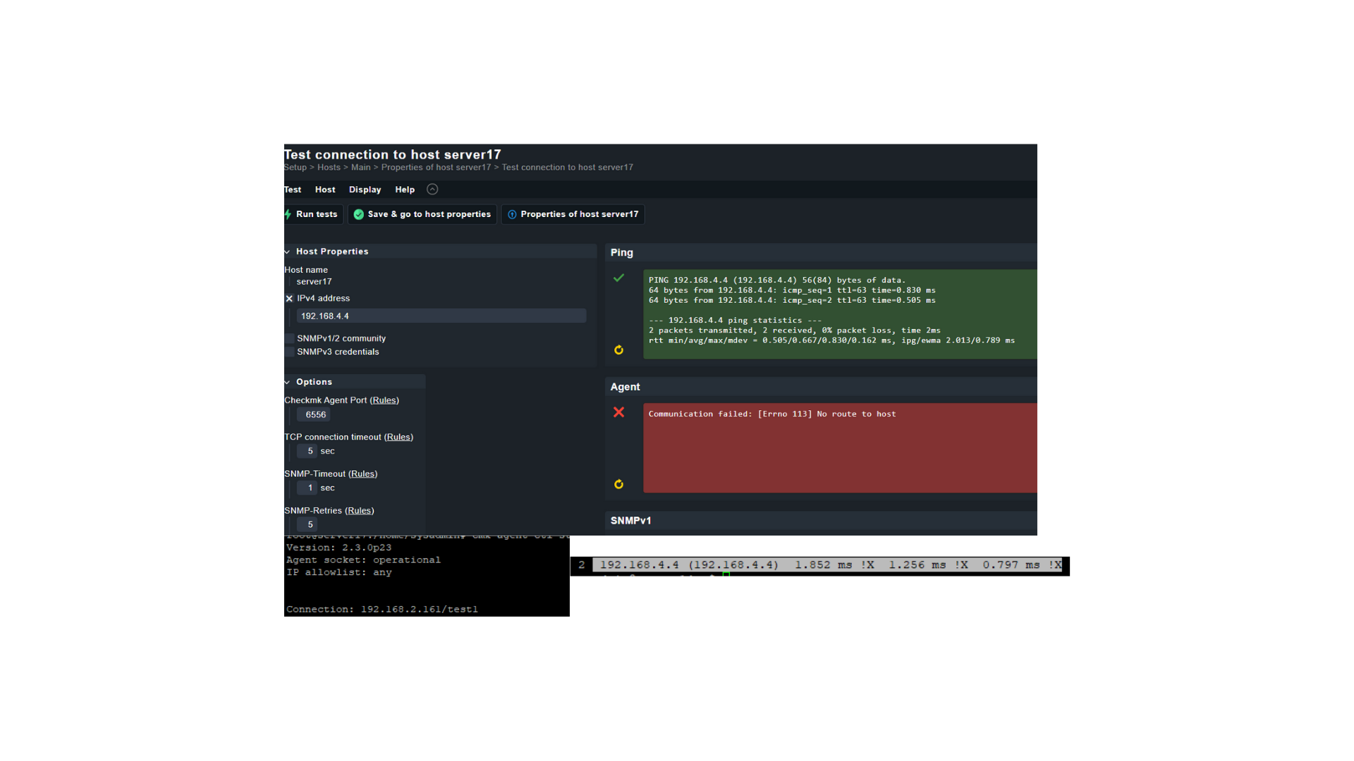

Comunication failed errno 113 even when the conection is fine on host
CMK version: Checkmk Raw Edition 2.3.0p23
OS version:Ubuntu 22.04.5 LTSCMK version:
Error message: comunication failed errno 113
I notice that the cmk agent wasn’t pulling new data, I re-installed the agent, register the host check the agent status and everything looks fine but I keep having the error when I check the connection on host setup. Doing a traceroute from the cmk server to the host server give me an error.
