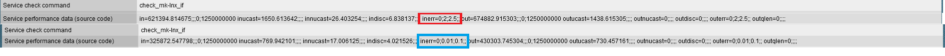

Now what I do see is errors whenever we Vmotion a machine, but just on the Broadcom NIC and that when I click on an interface (Broadcom / Intel) in CheckMK, I can see that the same check is used (check_mk-lnx_if), but that there are different parameters used to calculate the errors - Is that correct? can I alter this? I want to use the same calculations for both interfaces, that might reduce the errors we regularly see when we for example move virtual machines from one location to another.
Blue is the Intel NIC (where I never see any errors)
Red is the Broadcom NIC (where I regularly see errors)
Thanks so far!
The Intel NIC (blue) uses the default settings and the Broadcom has already altered settings.
But now it gets a little bit confusing. In your first post the problem where discarded packages and now the problem is in-errors?
In your screenshot you see that booth interfaces have actual discards and this is “normal” if it is not too much.
The in-errors you should have very seldom.
That’s also the reason why the default value is very low with 0.01% of packages.
Your actual rules you see if you use the
Yes, I had 2 so called issues, one was the in-discards, which I first thought only appeared on the Broadcom NIC’s the second issue was the in-errors that periodically appear. So the first issue is addressed as both the Intel as Broadcom cards have the same behavior, and now I am focussing on the in-errors!
