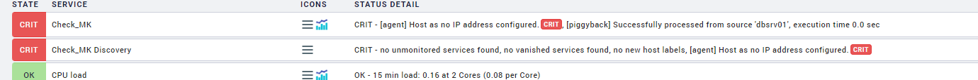

we test now to work with piggyback hosts, when I create the host so I have to add also an ip address, here I select no ip, but the Check_MK and Check_MK Discovery Checks are critical, how can I solve this, see below:

You also have to set “No agent” in the properties, as this host only gets piggyback data.
thanks @r.sander it was the right answer
