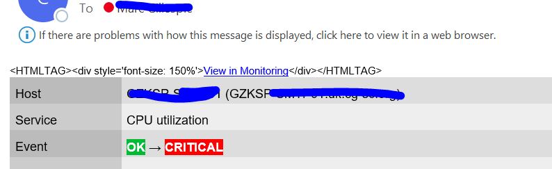

Also it is coming through like this in my email notifications:

How can you get it to appear nicely in the table though? Even without ServiceNow it still appears above the table as in my screenshot above?
I see, that is how we do that.
When you set the notification option »URL prefix for links to Checkmk« to automatic http/s, the Hostname will include a link, but not to the service overview, instead you will get to the host status. Does this help you? From there you can click on »Services of Host«.
