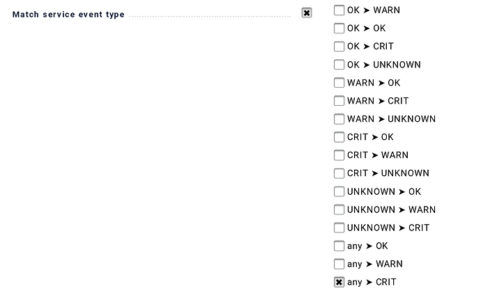

You can setup this in your nofitifaction rule:
You have to setup both rules (WATO → Host & Service Parameters):

So this is what I’ve done:
Notification settings:
Ruleset settings;
(I can’t post second screenshot)
I just made the ruleset and added this parameter (so is for all host/services)

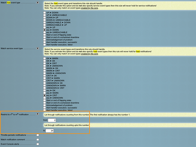

Just one more question, regarding this screenshot:
What exactly this mean, I’m not sure.
Thanks again.
if you have rules for “Periodic notifications for … problems” then the 2nd to 24th notification is sent.

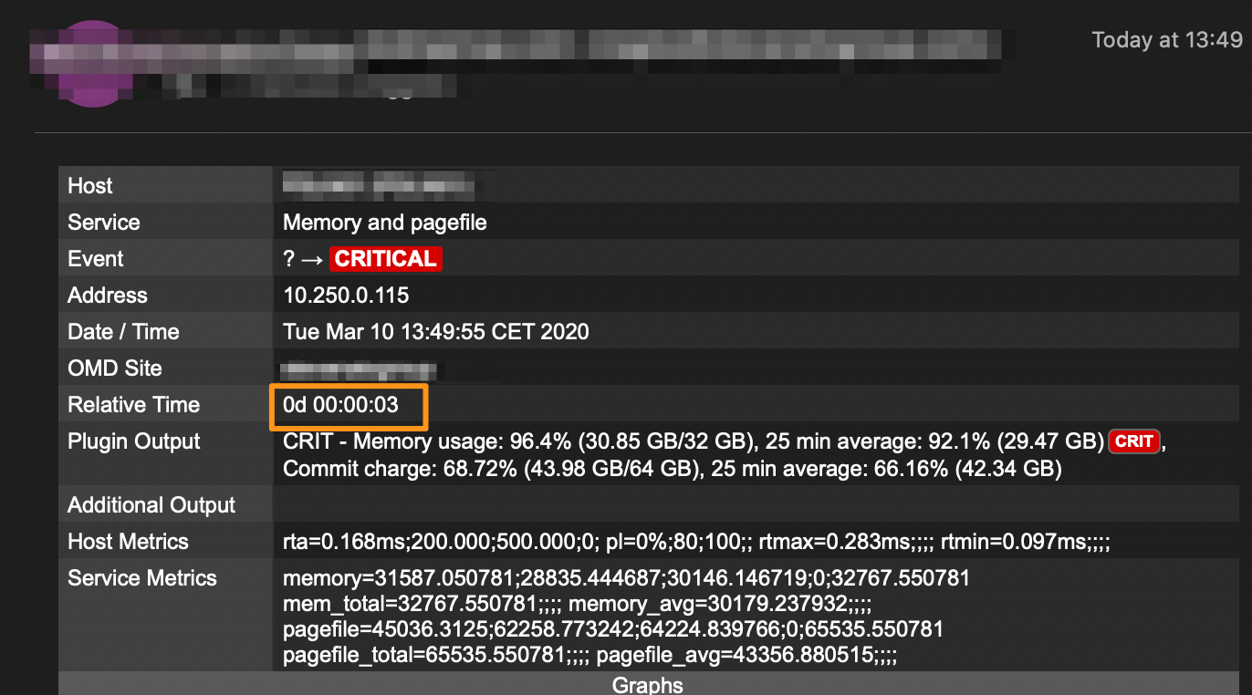

The goal that I want to reach is simple, I have to make KPI for the alert that are staying “not managed” (critical alert) on WebConsole.
So I need something that notify me if the alert still there or another method.
Let me know if is not clear.
Because whta we did not allow the monitor system to resend notification after 60 mins BUT dont allow the specific Notification that I’ve made to send only afer 1h, but it send istantly.
