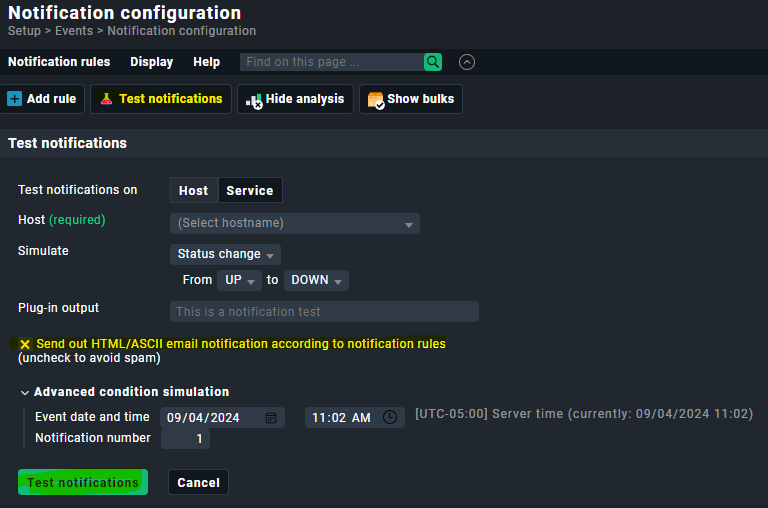

Hey all,
So I figured it out… It was the “Test notification”:
When I use this function it does NOT run the scripts, despite the fact that notify.log says, it did. So when I configure a rule that matches some “real-life” notification, the custom scripts run as intended.
Best,
MAp
Yea it seems the test function only cares about the HTML plugin, I have never used it.
I normally use “fake notifications” as this will trigger any plugin that is relevant and configures.
