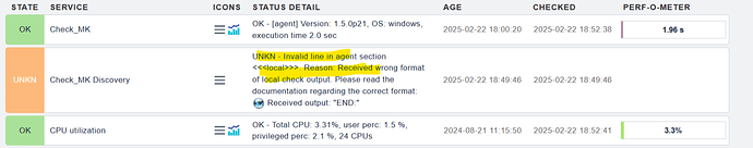

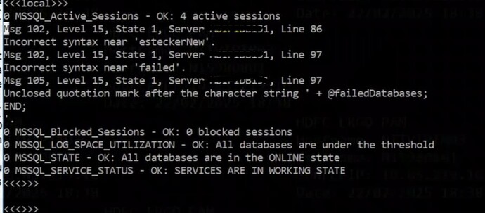

**Snip: **
When running the “check_mk_agent.exe test” command, the output shows an error if there is a typo in the SQL query. This error causes all plugins to disappear from the UI.
and same one error plugin script, i see in UI below error.

Senario:
there are 4 bat plugin which call 4 sql query.
Now output of 4 check work fine, and now 1 check is failed for output print (due to human error)
and when i run check_mk_agent.exe command, it print output for 3 checks in (cli) correctly with one having error. but due to one bad check all working 3 checks getting into error. (which has nothing to do with error)
The problem is your one bad check crashes the complete local section of the agent output.
If you work with local checks you have to ensure that the output is without errors.
If your failed check would be the last in the local section then all the checks at the start are shown correctly.
