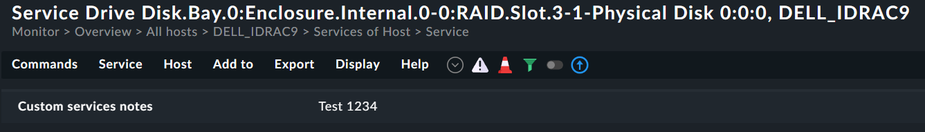

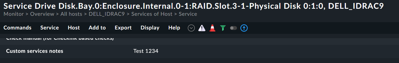

I can only say it is working as expected.
Here my test.
OMD[cmk]:~/etc/check_mk/notes/services/*$ echo "Test 1234" > 'Drive Disk.Bay.0:Enclosure.Internal.0*'
Result
and
