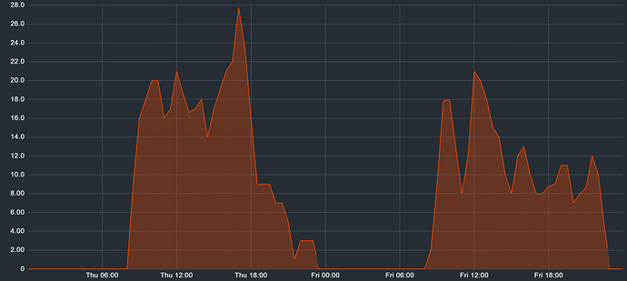

As an example, here is a graph from july 4th that’s still not aggregated:

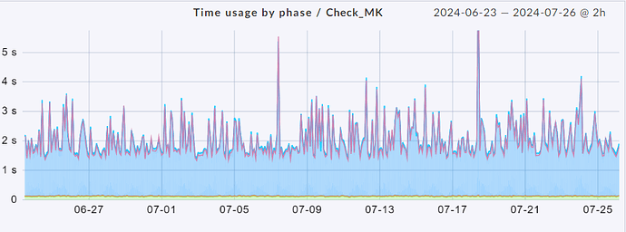

If I try to obtain that data up to today, I get a 6 hours step:
I’m pretty sure the data is still there, I’m just getting a step too big

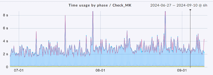

Edit: same extraction up to september 1st:
Your graph from july 4th show the correct 30 minute resolution.
What happens if you only try to fetch the data for this date?
I think you see this step here from the graph.
This has nothing to do with the real stored data.
If i change the zoom settings a little bit, i get a complete different step value.

If I only fecth data for that day I get a step of 1800 (30 minutes):
