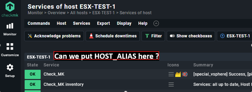

I was wondering if it’s possible to add the HostAlias of my host after the host title,
because sometimes it would help me understand the purpose of the host (I usually put more information in the host alias).
Regards.
Regards.
There is no easy way to add the hostalias to theheader of a view. Sorry for that.

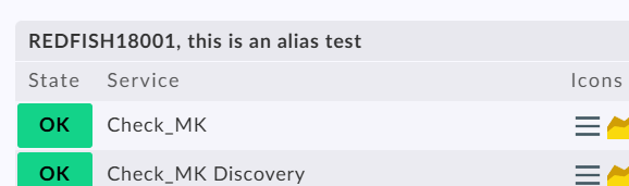

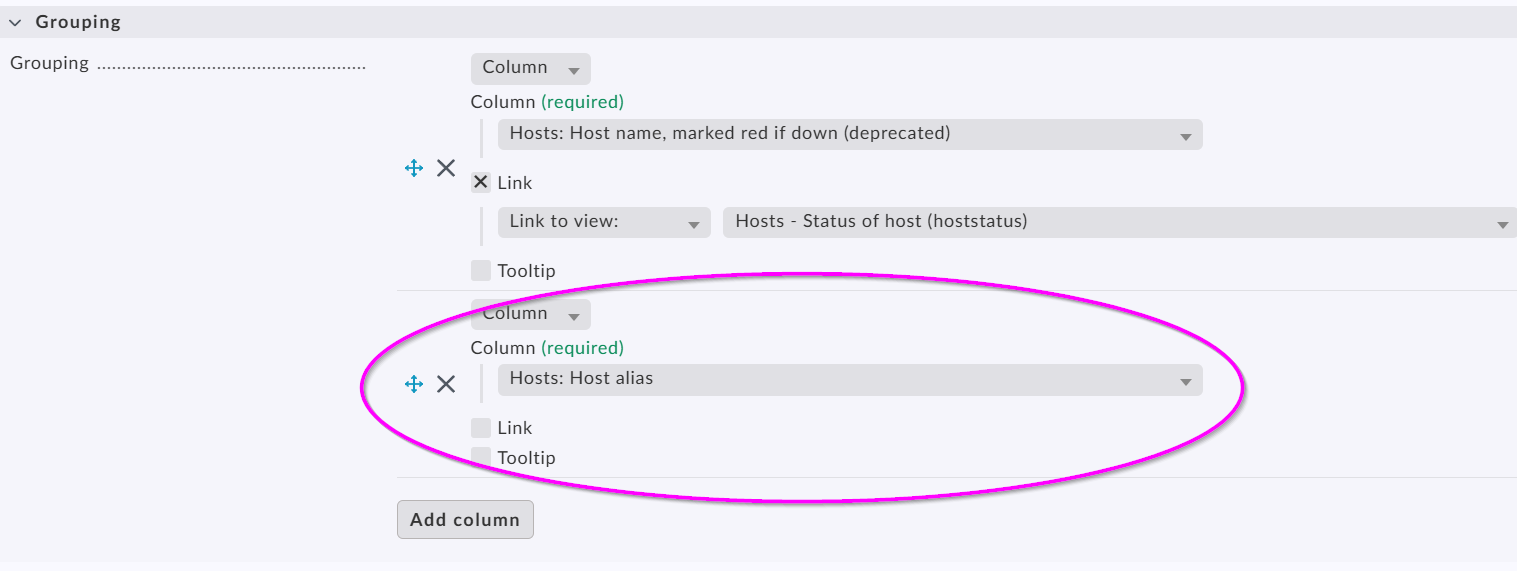

It is possible very easy - clone the view and add the following grouping.
The result looks like this then.
