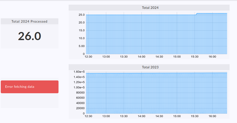

I am pretty sure, that the root cause is the “high” value of 151277 which I want to display. Perhaps only 32-bit numbers are supported by ‘SingleMetric’ and ‘Gauge’? The ‘Single metric graph’ is not limited by this.
Here I demonstrate the problem:
The lower Dashlets are identicial, but reference a metric which is large. How can i fix this? There seems to be no other dashlet, which can display a simple number.

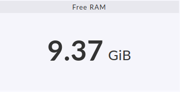

I am sure, it worked in an earlier version of 2.2, but I have not kept a log of upgrade events. So I cannot tell for sure when it stopped working here. Upgrading to 2.3 is not an option right now for me, I have to wait till Fall for that. I notice, that your metric shows the unit ‘B’ and tried to test with RAM free as well. However, it shows In 2.2, I cannot specify a metric unit and RAM free shows GiB and not a large number:
I changed the metric definition to it being rendered in Bytes instead of GiB to test your hypothesis, that the dashlet can’t handle large numbers. In 2.3, changing the definition is very easy, that’s why I did it there.
