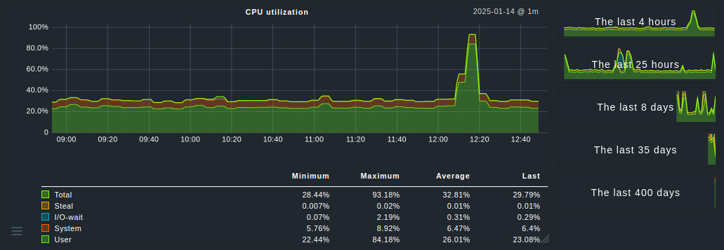

Regarding your question: Are you talking about this view for example?
Because there are already pre-defined time frames, which can also be customized in the global settings.

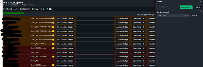

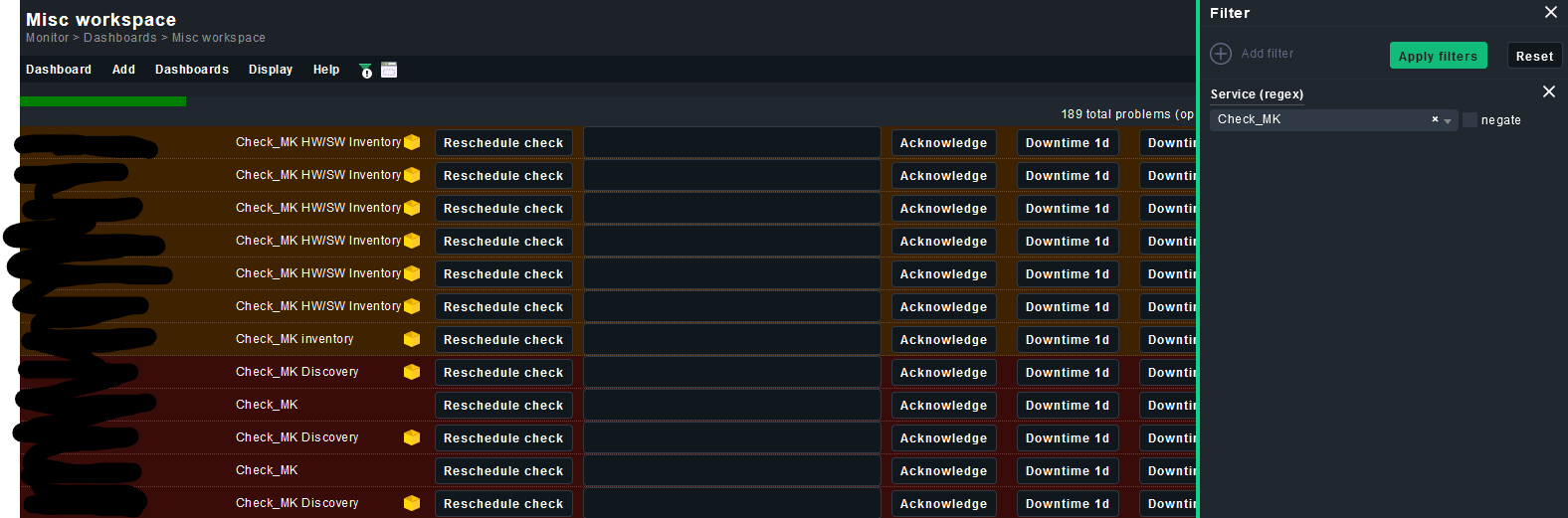

If the filters had the possibility to select time ranges or intervals the solution could be there. I can read and apply the context filters (permanently set in dashboard) and on-the-fly with the filter dialog to filter for services names:
But there is no filter for time ranges.

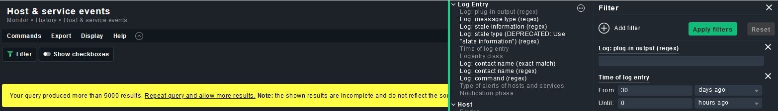

In views it is possible to access the log table and modify the time range of interest:
