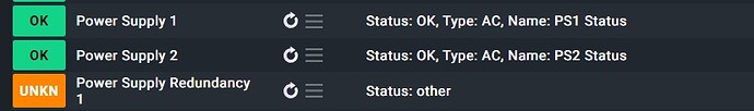

i monitored an Dell IDRAC on an Power Edge Server .

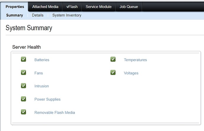

CheckMK shows me an UNKNOWN Service “Power Supply Redundancy 1”, but on the IDRAC himself i cant find any error or Warning .
Both Power Supplys shows green .

Unknown means here - “I don’t know what is the status”.
It will be important what comes back from the iDRAC as data.

I understand . But the IDRAC on his management Website shows no Errors or Warnings .

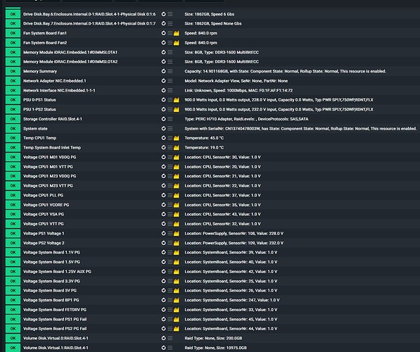

But you can have a look at the agent output and search the power section.
There should also be information included for the PSU redundancy. It would be nice to see if there is good information or also some stupid things.^^

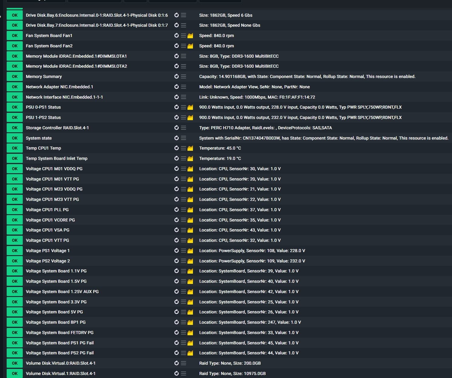

This is what i see in the Moment about the IDRAC Infos from this Server :slight_smile:
This one.
looks good - specific redundancy check for PSU is missing as i said.
