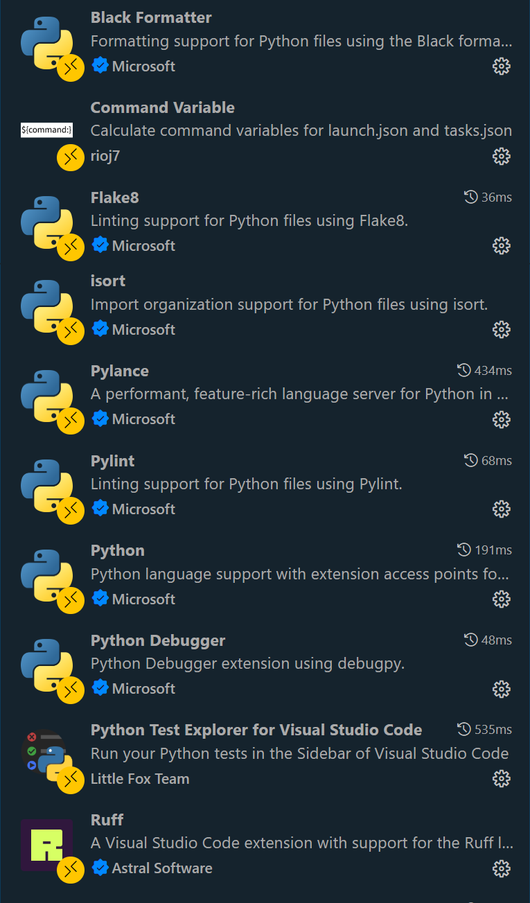

For my dev work on the Checkmk plugins i only use these VSCode extensions.
The “Python Test Explorer” is not needed for normal development it was only used for the tests to submit to the github repo of Checkmk.

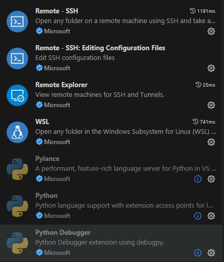

The WSL one is just because I run a WSL2 container on my work Windows laptop to ease accessing my Linux resources. It’s not needed for development as far as I know.
Here’s the <OMD_ROOT>/.vscode_server/launch.json
Again, this is what I came up with to get the VSC debug tool to run. It’s not official, and I don’t promise it will work for you.
