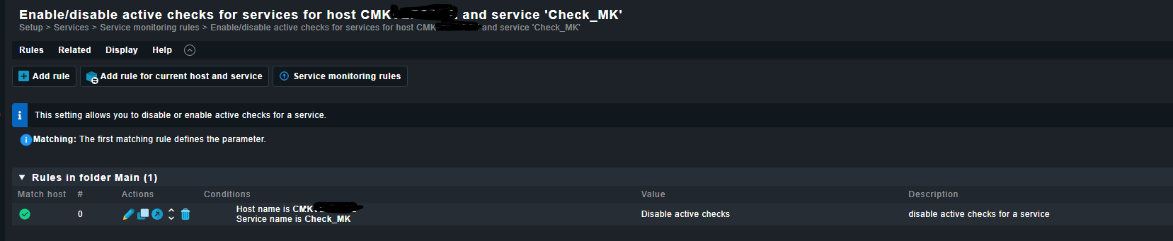

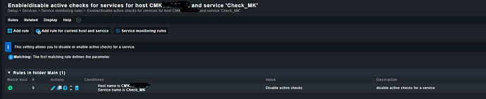

I tested and created a rule for disabling Checkmk service inside the host cmkhost and activated the rule but unfortunately the rule is not reflected inside the GUI. .
        "ruleset": "extra_service_conf:active_checks_enabled",
        "folder": "/",
        "properties": {
          "description": "disable active checks for a service",
          "disabled": false
        "value_raw": "'0'",
        "conditions": {
          "host_name": {
            "match_on": [
              "CMKHOST"
            "operator": "one_of"
          "host_tags": [],
          "host_label_groups": [],
          "service_label_groups": [],
          "service_description": {
            "match_on": [
              "Check_MK$"
The check is still active.
I think “Disable active checks” is not the right ruleset:
“Setup->Services->Service discovery rules->Disabled services” should be the right one for you needs.
