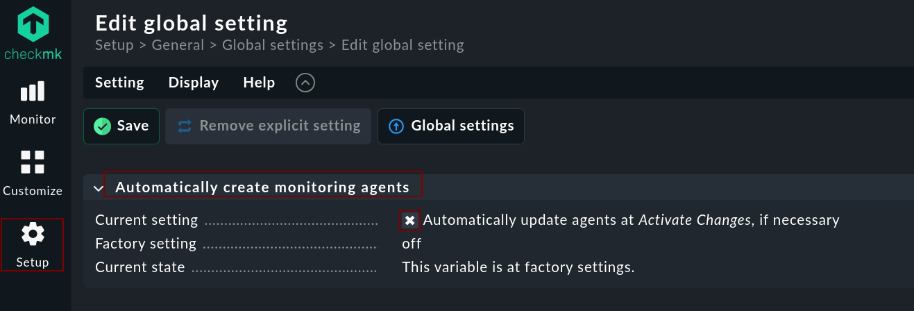

Hello @dom_666,
is the option “Automatically update agents at Activate Changes, if necessary” activated in Setup?
Karl
Hello @kdeutsch
Thanks for the reply, but no this setting is not activated.
(It also doesen’t happen if I manually Activate Changes, it probably happens after another automation that scans for new hosts.)
This is the answer, when a new host is created the host is added to the list of hosts that should have a new agent. What kind of agent bakery rules do you have as there are so many ways an agent can be baked.
