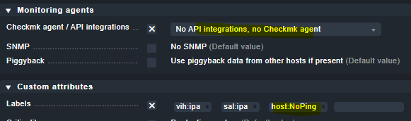

So I configured the following properties:
I created a rule Setup>Hosts>Host monitoring rules>Host Check Command that the host is always UP:
I created a rule Setup>Services>HTTP, TCP, Email, …>Check hosts with PING (ICMP Echo Request):
which leads now to the following status:

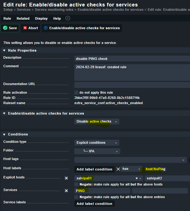

Feels like you have made a logical error here:
Host labels value has not seems to conflict with your Explicit hosts values. Maybe negate the Explicit hosts?
Personally I would use rule Setup > Services > Service monitoring rules > Enable/disable active checks for services instead.
Set it to disable, set host label and specify service(s).
thank you for the idea.
So I gave it a try and removed the rule in Setup>Services>HTTP, TCP, Email, …>Check hosts with PING (ICMP Echo Request
and created as you advised a new rule in Setup > Service Monitoring rules > Enable/Disable active checks for service:
but unfortunately i still shows the same situation.
I tested just now in my network, and although the rule is matched, I don’t get it to work with PING either. Probably should have tested it first, before posting it.
