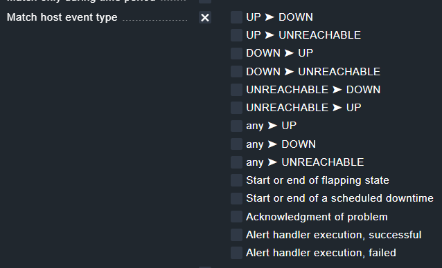

How about disabling the host event types in notification rule?

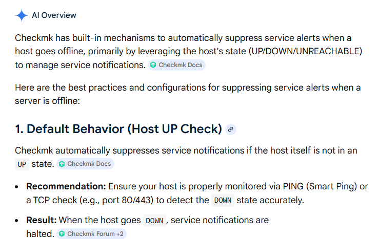

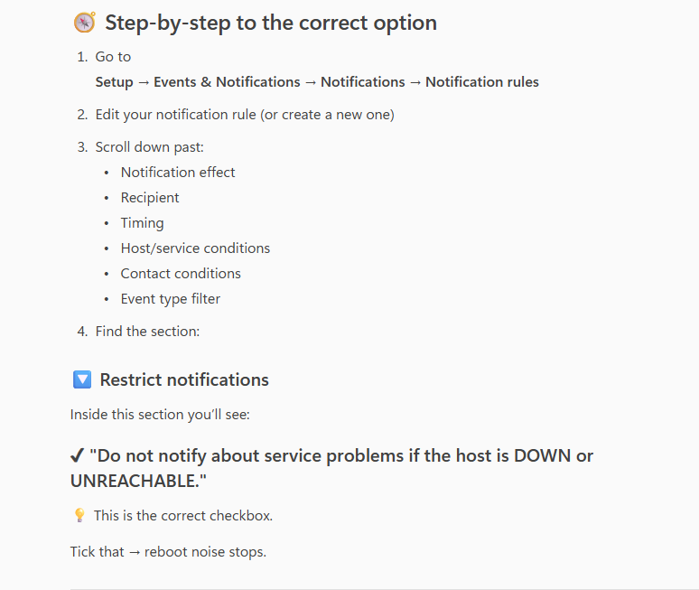

AI tells me this but I can’t find this rule.

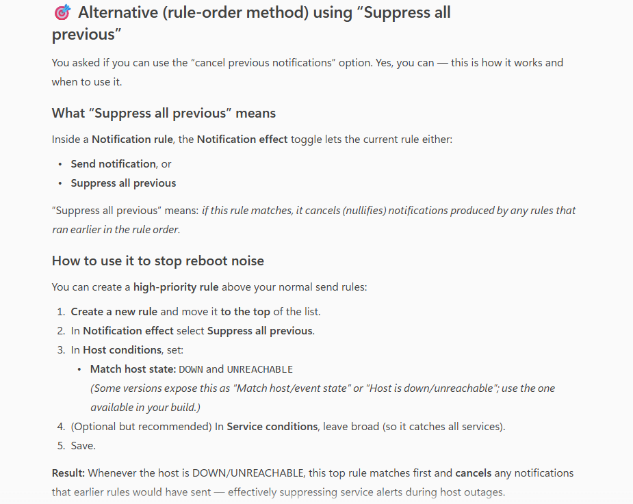

It also says this
Would this option work?
I presume and it looks like from the checkmk documentation there is built in funtionality where services shouldn’t alert when a host goes down.

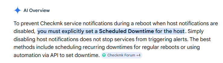

Ok, I’ve raised then with technical support because I am getting a lot of service alerts becoming critical for hosts that I’ve configured the rule to disable host notifications for. I performed a reboot on these hosts to see what happens.
Although it may be the case just to expect service notification alerts during a reboot unless scheduled downtime has been applied?
And disabling host notifications only prevents service notifications when a host has been shutdown?
This being the case if we should expect service notifications during a reboot then maybe the way around that would be to setup the ‘cancel’ notifications rule somehow?
