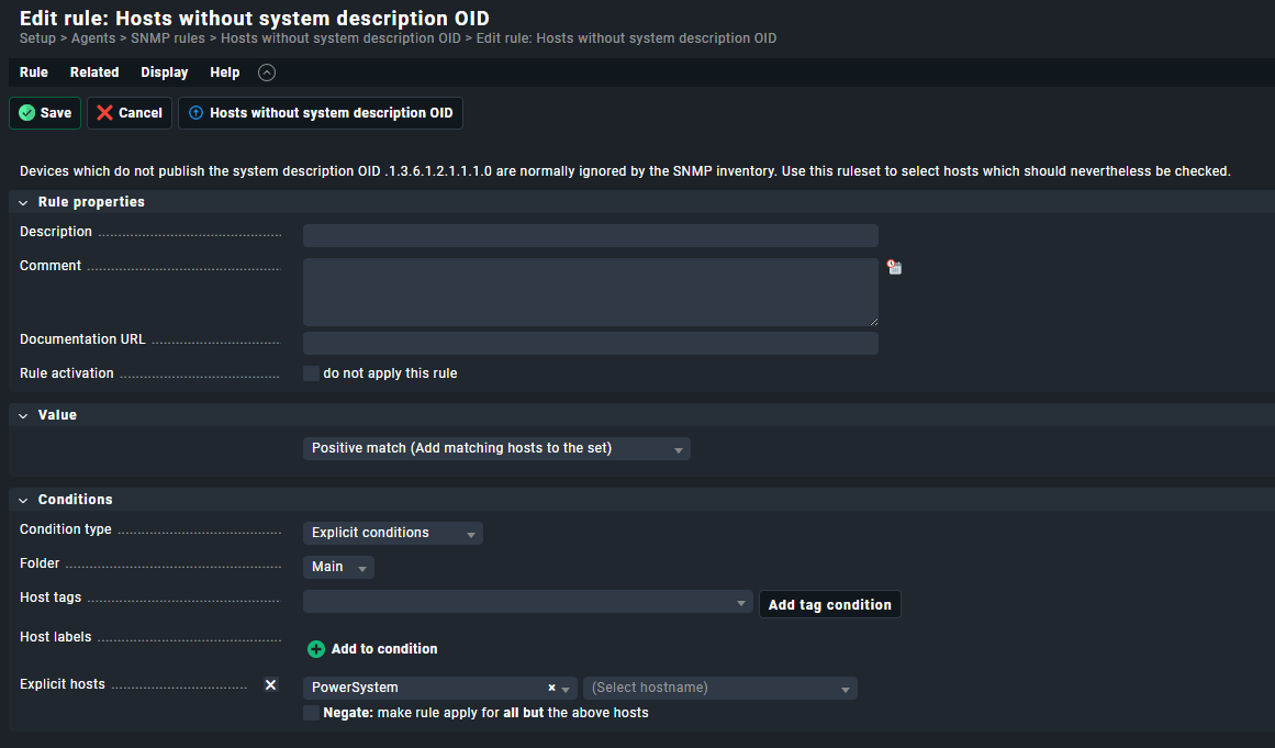

I posted about this earlier but deleted it because I thought I had it. I have a Leoch Battery device. They ONLY use private OIDs. I know checkmk normally will scan the .1.3.6.1.2.1.1 and first use like the sysDescr .1.3.6.1.2.1.1.1. then from there you trigger your additional plugin. Unfortunatly their device doesn’t return that at all. I was trying to query one of their private OIDs but that doesn’t seem to be working. I fear that because the device doesn’t return a sysDesc then checkmk is just abandoning all together. How can you handle this situation when developing a plugin for a device that doesn’t use sysDesc

Also I have added it to the rule that tells it the device doesn’t have sysDesc
