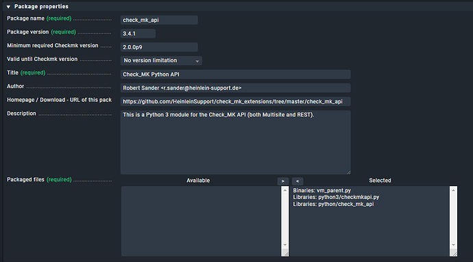

You also need to update the check_mk_api MKP.
I have already the version 3.4, may I need to change some configuration here?
Or what command do I need to enter in the Cronjob.
Currently I have:
python /omd/sites/(my-site)/local/bin/vm_parent.py -s (Monitoring link) -u automation -p (key)
The current version for checkmk 2.1 is available here: Checkmk Exchange
You also need the Python3 version of the vm_parent.py script which is available here: check_mk_extensions/helper at cmk2.2 · HeinleinSupport/check_mk_extensions · GitHub
Where do I need to store them?
You can download and install the helper MKP. It contains vm_parent.py.

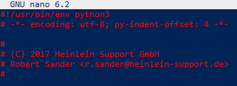

Does $OMD_ROOT/local/bin/vm_parent.py start with #!/usr/bin/env python3?
Yes.
There is the error. You cannot start this script with Python 2 any more. Replace python with python3 or just omit it as the script itself has the correct hashbang and should be executable.

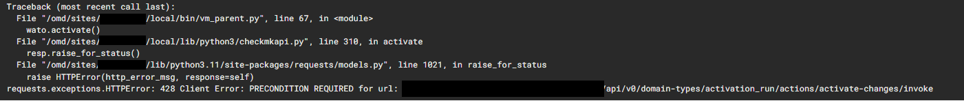

Just one question, is this normal after applying their parents?
This is due to the latest change in the API. Now an eTag is required to activate changes. I have not incorporated that change into the code of the API wrapper yet.
