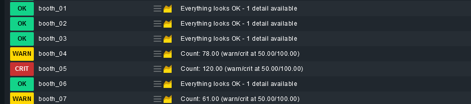

Your case has taken my attention, and as i like to explore stuff i made the following (in not having a Oracle DB server i resorted to mariaDB) Localcheck.
Just a simple setup:
I created a DB cmk-test, with in it a table called toll_booths with 3 columns:
  • booth_id int, uniqueID, auto_increment
  • booth_name varchar, booth_<number_here>
  • booth_errors - int, only has the value of errors detected
I filled the table with the example data you posted initially ( so 7 records) :
Next i created a localcheck on the database-host with the following code (dont forget to make the script executable):
#!/bin/bash
set -f
IFS=$'\n'
results=( $(mysql --batch -uroot -pMySuperSecretPassword -D "cmk-test" -N -e "select *  from toll_booths") )
for line in "${results[@]}";
do
    booth_name=$(echo $line | awk '{print $2}')
    booth_errors=$(echo $line | awk '{print $3}')
    echo "P \"$booth_name\" count=$booth_errors;50;100;;"
done
This resulted in the following results in the CMK host-checks ( after rescanning.accepting):
So from my perspective it is even possible to bypass the ‘write-to-file’ - part, and directly query a database and use the results to generate results in CMK.
Again, do mind this is just a proof of concept, i can not determine if (without further logic) it is wanted to query the database directly, as the script is not handling database-down - issues and thus process it.
But atleast via Localcheck this could be usable (imho)
So if a direct query can be made to your OracleDB, with the correct parameters a similar result can be achieved.
