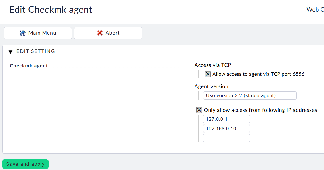

I am then here available if you care to explain how to make it work since the appliances have indeed the agent installed already but the query is only possible through localhost!
When querying from central to the remote site, ping is correctly shown, 6556 is open only locally by design.
Of course Andreas, correct me if I am wrong.
BR
No you can configure every IP you want to be allowed to reach the agent.
localhost is only the default setting
With current agents i would set no IP here and make a TLS connection.
Thanks Andreas, this solved the issue, still, from what I’ve seen this is not documented in any KB about distributed monitoring.
Not KB but inside the normal manual for the appliance.
welp, you are right.
Thx
