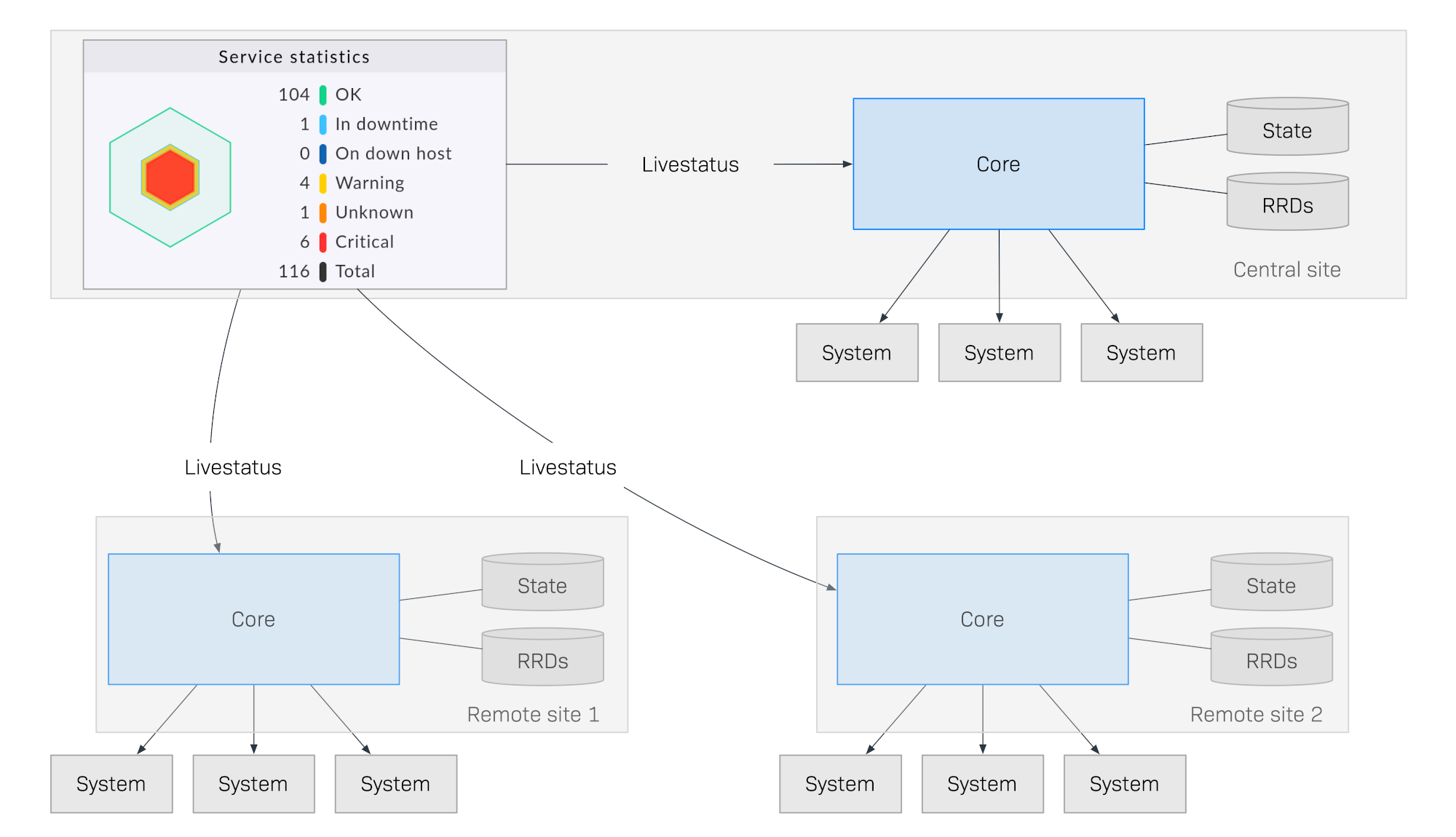

Imagine you have three datacenters, Asia, EU, US, for example. You have a monitoring site running in every one, with one of the three being the central site (let’s say EU). What happens if all the monitoring data was collected centrally and the now the network connection between the locations has a problem, or the central server crashes. Then all the other sites would be useless as well.
However, if the data is stored decentralized and something happens so that the central site can’t be reached, the other sites are fine and keep chugging along. Better yet, they can even let you know that of the other sites may have a problem.
Does that make sense?
Curious to hear why you think this setup to be “completely useless”, and the advantage of the data being sent to the main server?
This picture from our docs illustrates it pretty well:
In case you haven’t taken a closer look yet, here’s the article: Distributed monitoring - Scaling and distributing Checkmk
It also mentions some other advantages of this approach that I didn’t get into.
