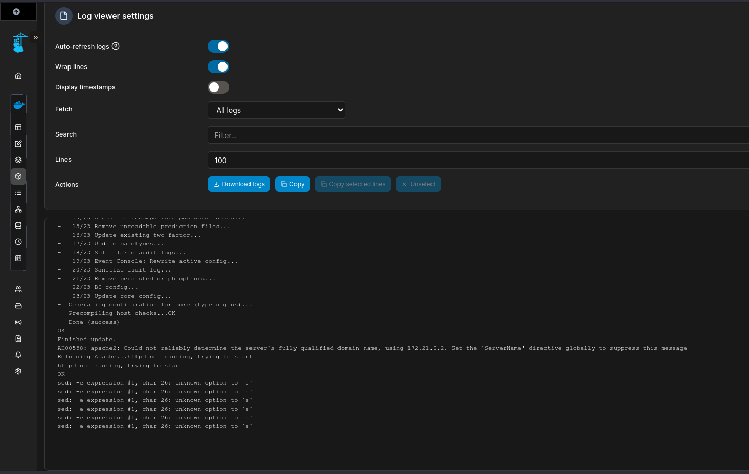

sed: -e expression #1, char 26: unknown option to `s’
Getting this error on container start, had to regress to p13 to restore service.

Yes, this is what is observed by tailing the container logs. Micky’s observation is what happens as a result in the browser window - 404 error.
Can you share the complete log and also $OMD_ROOT/var/log/web.log ?
This is all I can get out of it, I can’t attach to the container itself as it states it is still in the process of starting. :expressionless:

I was able to get the container running under a different name via a command line start and not using the docker-compose.yml statement I was previously using. I was using Traefik as a proxy to CheckMK, so I believe the problem lies there.
Yes, it doesn’t look like a Checkmk problem to me. I tried to follow 2 different upgrade paths with the Raw edition i.e. CMK 2.2.x > 2.3.0p14 and CMK 2.3.0p12 > 2.3.0p14 and cannot see the error.
