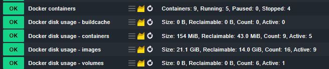

as a result I get this picture, this additional line:
compared to a node, where pip3 install docker as root was possible, because the python3-requests was not a conflicting issue:
maybe an additional important fact: on the node, where I helped myself by adding the python3-docker package, I’m dealing with podman (!), not docker
The extra filesystem only depends on your containers running and the configuration of these. I have only these on some of my docker hosts.
Normally they get a “auto ignore” rule :smiley:
podman cannot be monitored yet.
We already have a ticket for this issue, I will discuss raising priority with my colleagues.
