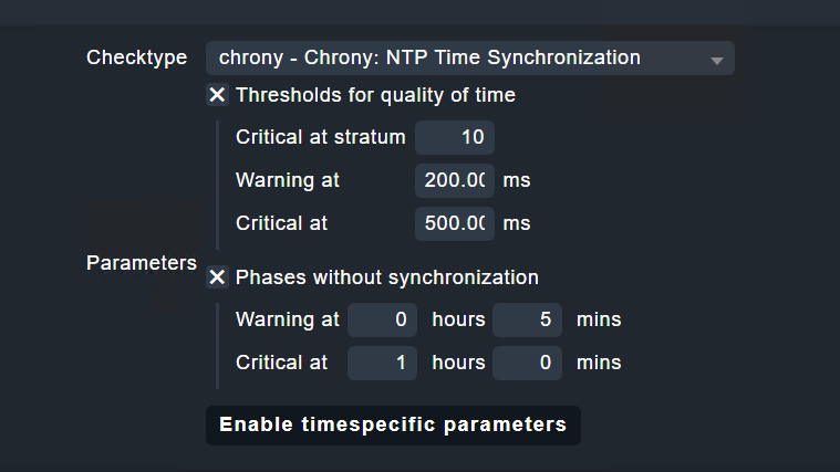

Than you can define the the quality of time parameters and use a very high value for the phases without synchronization.
Keep in mind that a default chrony on Redhat has a sync interval of something like 64 seconds and not 30 minutes. The default rule makes sense for such a default configuration. If your chrony is deployed with an own config for the sync interval than you need also to adjust the parameters.
But wouldn’t setting the Phases without sync setting to something big, also more or less disable the check whether Chrony syncs at all?
With exception for the sanity check in regards to the quality of time.
If the solution to check for how long ago it was since Chrony was synchronized is to just up the time, we could just disable this part of the check entirely since it wont have any affect, which feels a bit backwards.
Chrony is still in sync and has checked other sources, just that it has not checked the source it considers to be the best.
I do want to know when it can not sync because then I can fix that before it goes out of sync if that makes sense. So the check to see when the last sync was seems valid, but not if it only returns the value for a thing which does not indicate if it is good or bad.
What is the reasoning for looking at the time since the last sync was performed against the preferred time source specifically?
The sync interval in the Chrony conf has not been changed so it is default.
