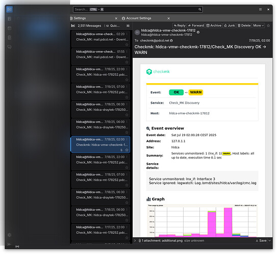

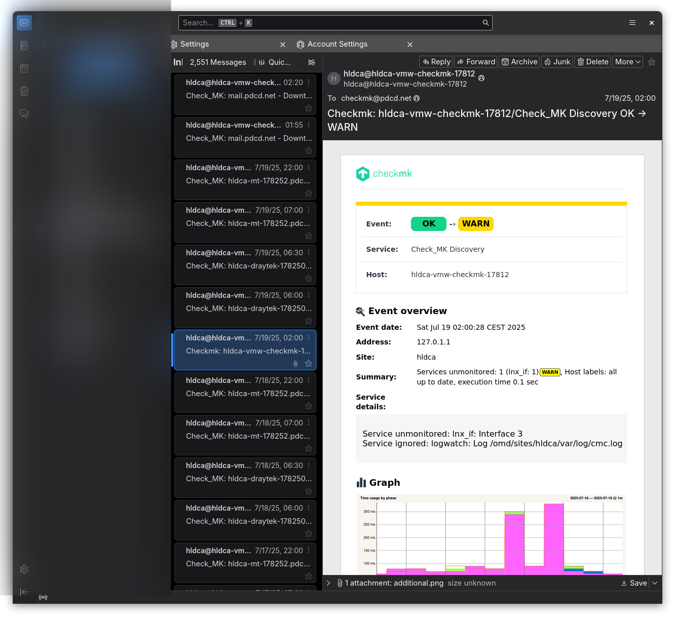

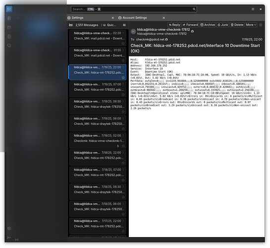

No error message, but downtime notifications are rendered in plain text instead of using the new HTML template. Other notifications (e.g., service alerts) are rendered correctly in HTML.
Description of the issue:
I am using a single notification rule for all events without any custom adjustments. While most notifications are rendered correctly using the new HTML template, downtime notifications fall back to plain text formatting, making them harder to read.

I would think your downtime notification is a fallback notification and not generated from your normal notification rules.
Is in your system a fallback notification mail address set?
Hi Andreas,
Thank you for your quick response.
You were absolutely right, the issue was caused by a fallback notification mail being set in the system. After setting all Notifications for HTML Mail, downtime notifications are now rendered correctly using the HTML template, just like the other notifications.
