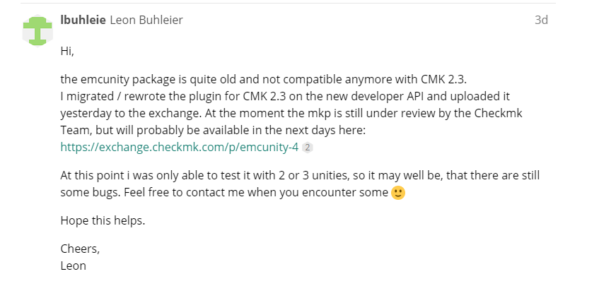

It still collects the information from the Unity, but there is an issue passing it to CheckMK:
Example output from cmk -d :
Ignoring outdated plugin ‘emcunity_fan’: Format no longer supported – this API is deprecated!
