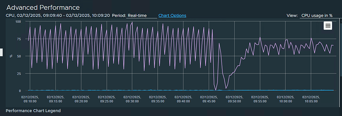

I was a bit apprehensive because you said it might have impact on performance but I see an actual improvement in CPU usage:
Left is before the change, right side is after the change. The middle is a reboot.
Thanks @lbuhleie

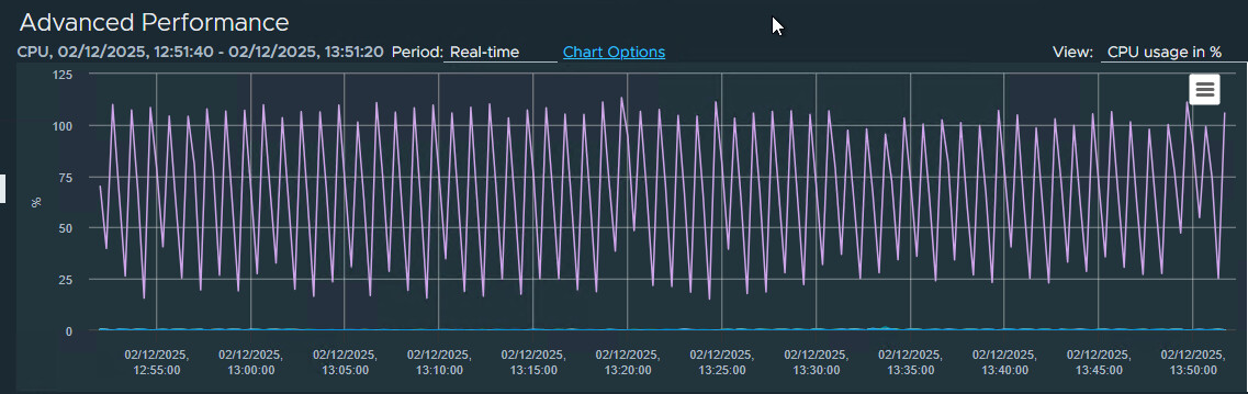

I might have spoken too soon:
Is there a way to make the check quicker or more efficient by removing some checks?

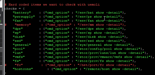

at the moment it is not possible to thin out the query of the special agent via rule. But you can of course look at the agent_emcunity script yourself and remove some of the checks.
This should be relatively easy as you only need to put a # in front of the checks you don’t want to happen in lines 104 - 118. The script should be located at ~/local/python3/cmk_addons/plugins/emcunity/libexec/agent_emcunity
Hey Leon
Thanks for the suggestions;
I adjusted the check like this:
I also removed the 90 seconds rule that I added according to your first suggestion
CPU usage seems about the same as before now.
and for now, the timeouts seem to have disappeared
