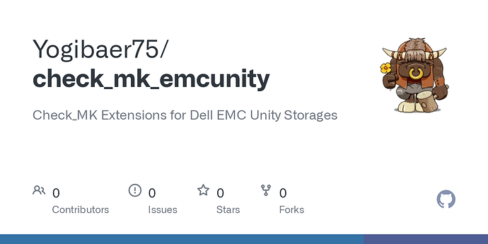

I think that you’ve installed this package: Checkmk Exchange
The repository for this plugin is here: https://github.com/ImTheLucKyOne/check_mk_emcunity/issues/24.

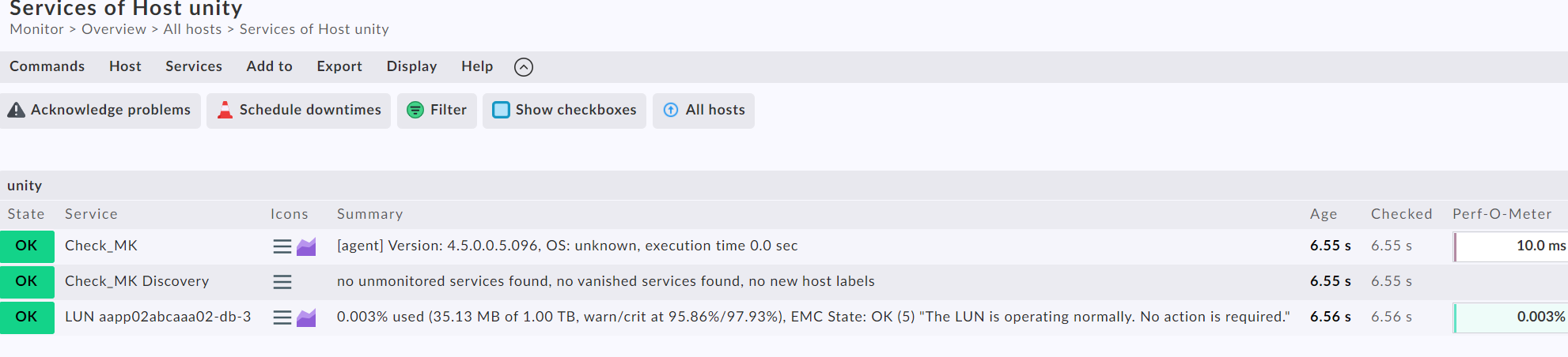

I have run and compare the emcunity plugin on checkMK 1.6 and checkMK2.0.
the same plugin running as expected and also giving the same output at CLI.
But when it comes to UI , in new CheckMK all the LUN related services are showing “Check faild”

The first step is done with the special agent. It is nice to hear that it is working.
I checked with your short of output of this single LUN and got no error.
