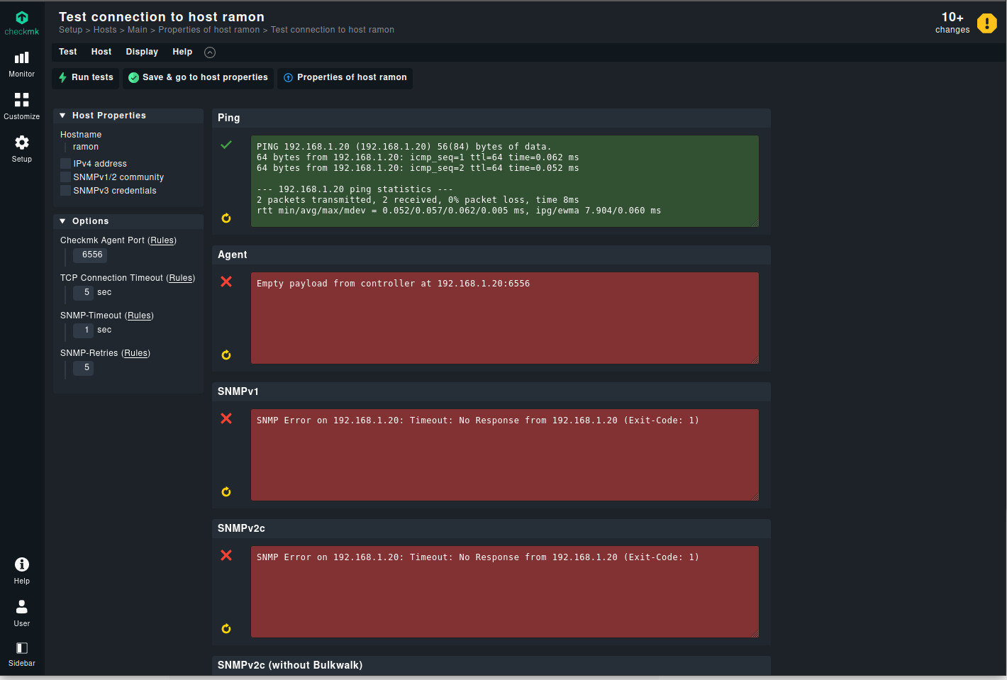

Also, I am getting Empty payload from controller at 192.168.1.20:6556 when I test connection to host ramon]. Which is probably why it never gets to local checks

Thank you for your reply Simon. I tried this and other variations of host names and IP address for the local host. When ramon.altre.local is used as host name (or 127.0.0.1 as IP address) with local the agent test still fails with empty payload, but all other tests succeed.
When I use IP address 192.168.1.20 ping test succeeds, but all others fail. The working host used “–server ramon:8000” in registration command and it is working fine. My current registration for ramon is also using --server ramon:8000. The tests are using IP address 192.168.1.20 the check_mk_agent still reports empty payload
