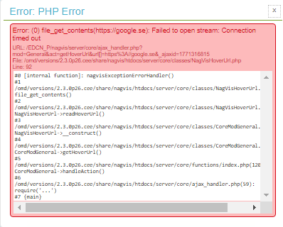

Error re google on airgap nagvis
CMK version: 2.3.0p26
OS version: Physical appliance
Error message:file_get_contents/https://google.se
NagVis tries to access google for some reason. We do not have anything that links to google. Our server is not connected to the internet so probably the error relates to nagvis trying to contact google.
How can we remove this?
You have a service where the URL “https://google.se/” is inside the output.
The Nagvis Hover template now tries to access this URL.

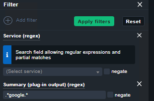

Can you be more specific when you say" “inside the output” ?
I have tried searching for all services with “.*google.*" in output:
Is there a search you can suggest to find the service or reference to google?

Additional info: The popup with the error shows up exactly a minute after the nagvis map is fully opened in the browser. My mouse is not hovering during this time.
