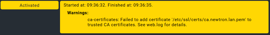

However, it appears that the plugin does not use the CA certificates stored in CheckMK, which is why the check fails due to the incorrect or untrusted certificate.
According to my own research, this is probably because the JSON agent is not able to accept SSL certificates without verification.
I have already tried storing the corresponding certificate under /usr/local/share/ca-certificates, performing an update-ca-certificates, and restarting the site.
The result was:
By the way, there was no entry about this in the weblog.
I haven’t gotten much further here yet. Do you have any ideas about what else I can do?
Hi.
Looks like that checkmk instance ownor has no permission to write in system cert store. Looks like is hardcoded in the special agent.
Best regards,
Christian
Is there any other possibility to monitor a this metrics via CheckMK?
This file needs to be world readable - but it is not.
Well, giving the certificates 644-rights worked for the activating of the changes.
Unfortunately it did not resolve my initial problem:
