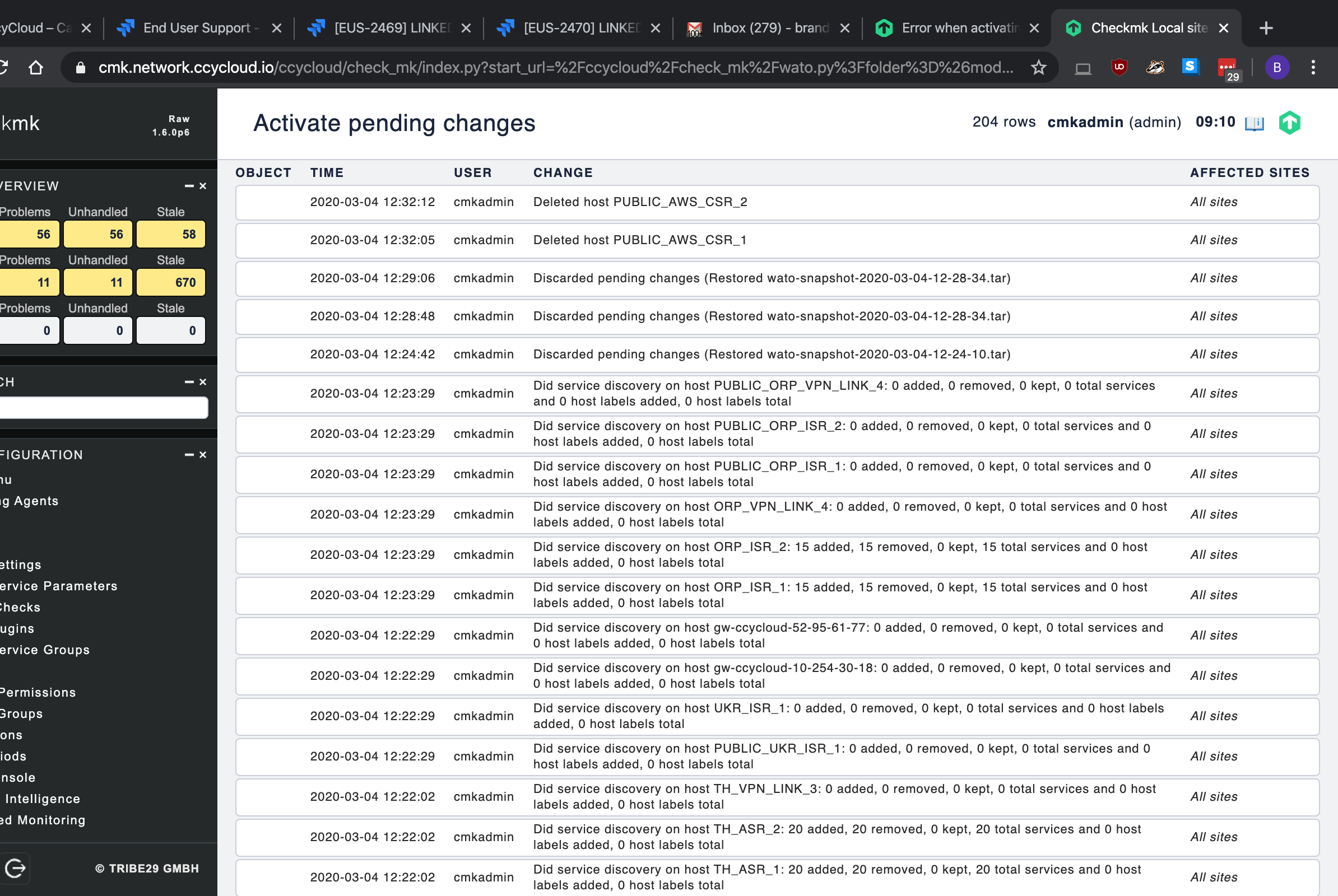

Can you please provide a screenshot of the changes you want to activate. Please censor sensitive information. But this would help to get a better understanding of the situation you’re stuck with.
Looking forward to your reply.
Thanks for the reply.
Yes I am deleting several hosts. These are no longer in service.
Doing a bulk discovery and Tabula Rasa to refresh stale services and remove the devices and update offline devices.
Please see attached screenshot below:
