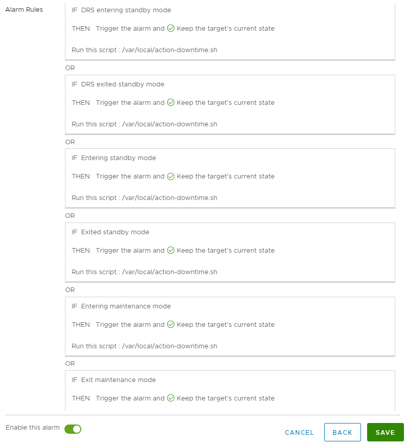

we trigger a downtime with a vcenter action when the host is put into standby or maintainance mode and remove those when it comes back.
the downtime wrapper script is here:
the alarm rule looks like this
but i really like the approach of @ttr! i have to try this out :slight_smile:
ciao matthias

Hi @mace and thanks for your answer. I see the approach but I would rather solve this from checkmk without interacting with the vSphere admins. Not that I don’t like them, I myself was one, but the solution of @ttr looks more scalable and easier to handle for me.
