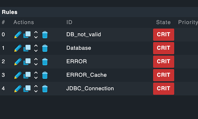

My Rule pack is looking like that:
Every Rule in this pack has the same clearing text to cancel the event.
But i have noticed, that when Events are generated, only the Rule 0 is working with clearing.
All other Rules are not doing anything.

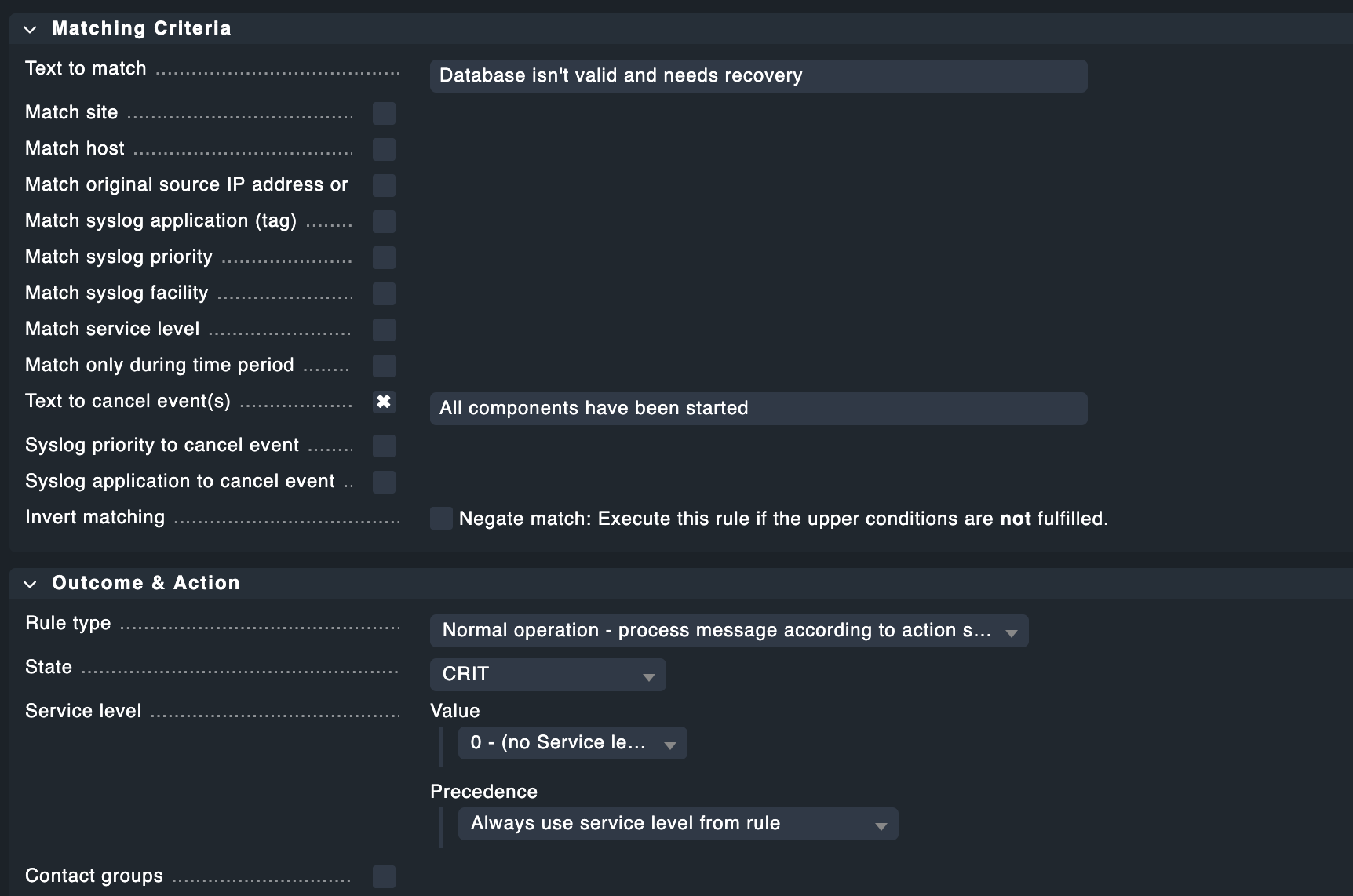

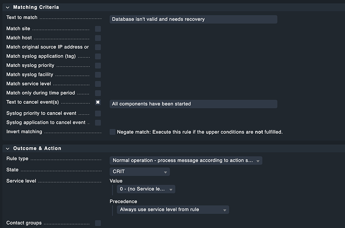

Every Rule of this Pack is configured like this: (of course with different “Text to Match”)
Under Rule Type, we are not skipping rules, … so why are not all different Events are getting cleared in the end?

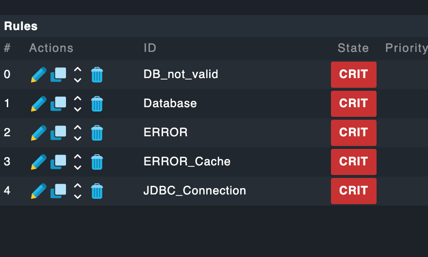

Today i tried to breake down the Rule Pack a bit and moved all Rules in a single Rule Pack, expecting, that i will have the proper clearing then…
Unfortunately not. Its also not working with this setup.
