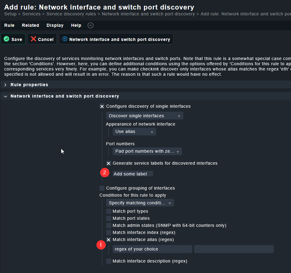

the rule you’re looking for is called “Enable/disable notifications for services”
you can either built the rule directly or by a service label. That service label could itself be set by one or multiple service label rules, but checkmk can also generate service labels for you if you have a way to detect the less important ports e.g. by their alias?
it might be worth to mark port aliases with something like #uplink or #access etc etc on the switches, this way you can classify them within checkmk but also have some additional information when you or colleagues are working on the switch. (And if it’s on the switch, other tools that might scan your switch also have the same information and not just checkmk.)

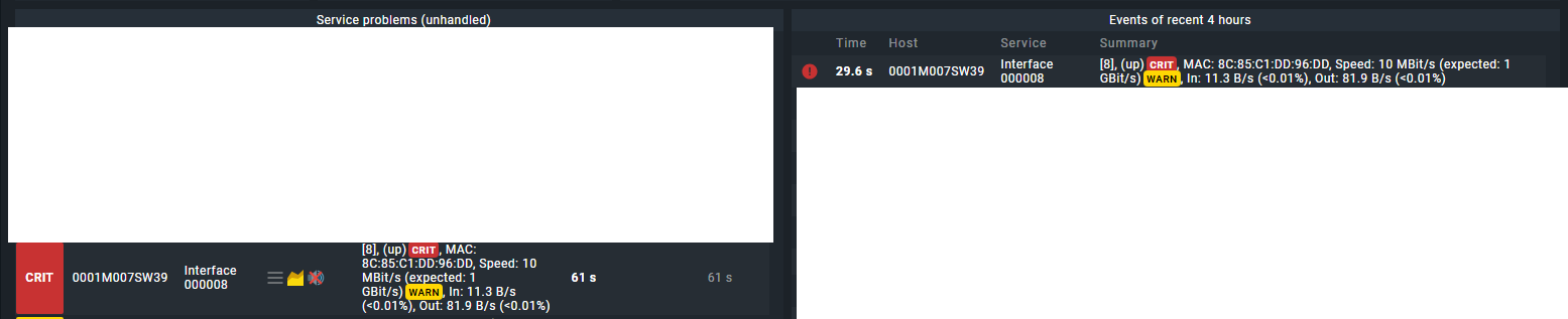

After few minutes, i powered on the host in Port 8 and i have:
On the right the action is logged and this is fine but on the left i still have the service problem with the only difference that this time it have a new symbol of mute on the right. Instead, our goal is to don’t have any service problem on this case but only log.

What you could do is, filter the dashlet on the left “Service Problems” so that only services where Notifications are enabled will be shown:
Now if someone opens the Switch directly, they will still see that this Interface is in a CRIT state, but the alert will not be shown in the dashboard.
However, it would still be counted in the Service statistics.
