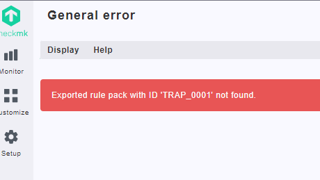

I tried to remove an old MKP but now the eventconsole is broken. I can’t acces the Events or administrate it anymore, always receiving the error, that a rule is not found.
EventConsole_ERROR1

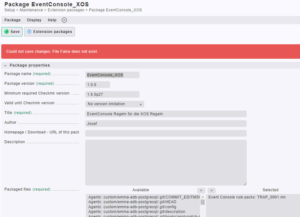

I also can’t edit the mkp itself:
Josef
