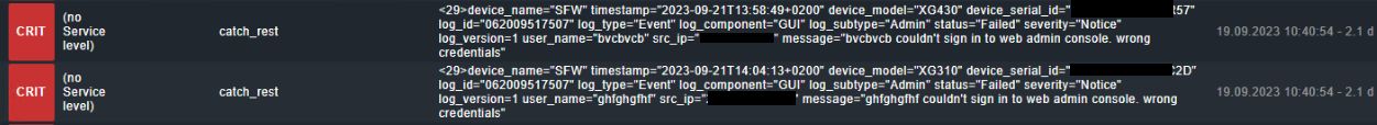

We are experiencing the very same thing with EE 2.1.0p27. Interestingly it’s always the same time of the last occurance, even among different hosts. The pattern here seems to confirm that checkmk has again trouble communicating with Sophos firewalls or vice versa. We’ve tested it with a XG430, XG 310 and XGS3100 and all behave as described.
Has there been any change or progress so far?
Otherwise I would open a ticket with the support.

I am glad it is solved for you, I also did the upgrade but the problem still exists on p33.
