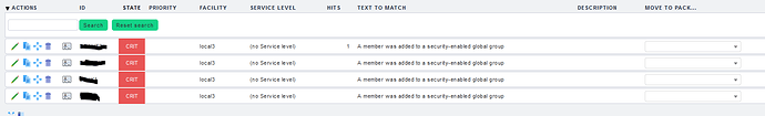

I created Event Console rules - try - green bubble. Ok

The next step is - how does your EC rule looks?
