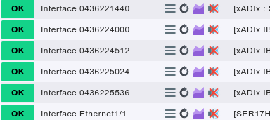

I have configured to discover network interface on our switches using the description as appearance of the interface. Since we automate the discovery (adding/removing interfaces), our network guy place a tag in the alias of the interface which they don’t want to be monitored: “xADIx”. Because of this I set up a matching criteria in “Match interface alias (regex)” like this:
(?!(xADIx))
I double checked with python regex checker, if this would match (or in this this case, it should not match).
But the interfaces with the tag “xADIx” still appear on discovery and they don’t use the description in the service name, but the index, which is strange as well.
interfaces
Did I misconfigure something here?

I tried this as well, with the same result. I figured, since the help says “match from beginning”, I could do it without the “^”. Either way the regex does not work, but it should, or am I completely on the wrong track?
The filter is set on the alias, the description is used for the naming of the service.
