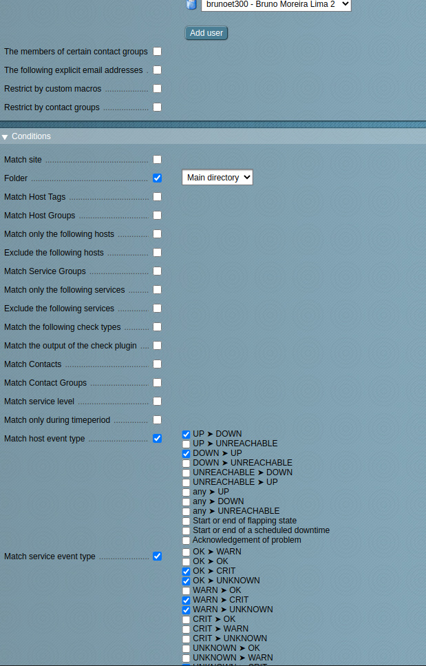

thanks for your quick response, i understand how the services work thanks to you, but when i test them the rule does not work.
to test, I drop a service for 1 minute so that I can time the time to send the alert, that is, in this time interval I want it to delay delivery, but the case is that it doesn’t, the delay is set to 3 minutes after 3 minutes of a downtime it should send an alarm, delaying the sending of the message.
