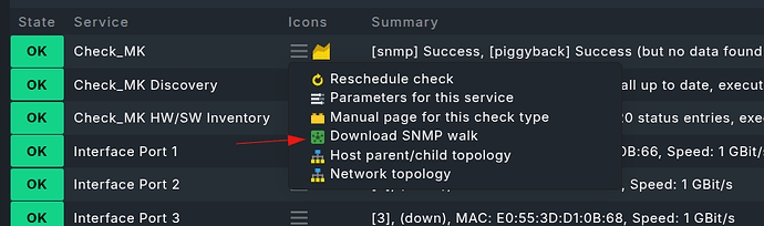

Maybe, if the device is already added in Checkmk, then you could also download the walk from the GUI?
Sorry - here you go:
rmk-wiarchivbrick2-walk.txt (480.7 KB)

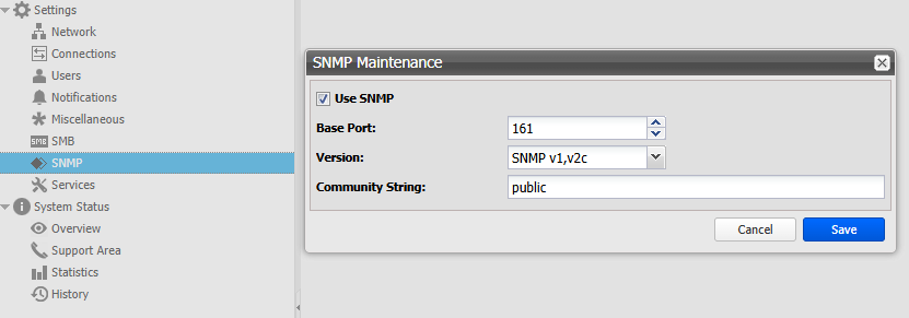

I´m not sure if I can configure anything inside the Fast-LTA.
Is SNMP is the way to go with this system? Or is there a better way I don´t know of (kind of like redfish for ilo).
Maybe check the Access Control / Views settings. The community string or user you are querying with is likely restricted to a generic view (often called systemview).
Have you checked if the view permissions are restricted ? or to add access specifically to the .1.3.6.1.4.1 (enterprises) subtree.If there is a toggle for “Enable Enterprise Storage MIB Extensions” or similar vendor specific options, ensure it is turned on.
